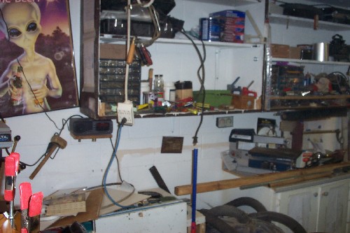

Again tonight it still holds steady at 45, don't know if you can see my hygrometer in this pic, right above the scroll saw, i bought it at Canadian Tire or Wally World for a couple of bucks.I definitely have to buy a better second one!
